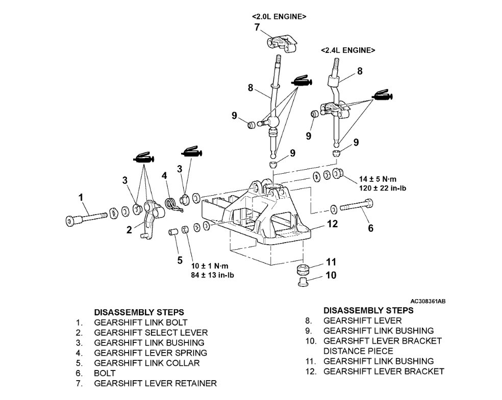

I need to know how my shift cables and the plate install? I forgot.

Yep, it looks kind of complicated. Here is a diagram that should help you reassemble. Check out the diagrams (below). Please let us know what happens.
