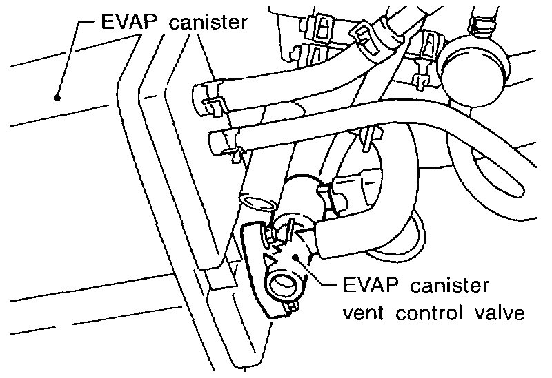

The code will not clear because one, it is stored in memory and two, you have not repaired the problem and the codes simply resets. You have a code for a vent solenoid. Have you tried changing it? The code is not going to go away if the problem is not resolved.

Okay, first, there is no gas pedal method to clear codes in this vehicle. Second, P0446 has nothing at all to do with a gas cap. It is an electrical circuit code for the vent control solenoid circuit so you can change the whole gas tank if you choose and still not repair this code. It could be a wiring issue but 99% of the time it is just a bad vent valve solenoid.
The p0440 is just a generic code caused by the P0446. Fix that and they both disappear.

The vent valve is attached to the charcoal canister under the car, near the fuel tank. See image.
To test the circuit use a bidirectional scan tool to activate the valve and then test for power and ground arriving at the valve plug. If you have both power and ground, replace the valve.
I also suggest that you use and LED test light when doing this and not an incandescent bulb type as the current required to light the bulb can damage the PCM.
