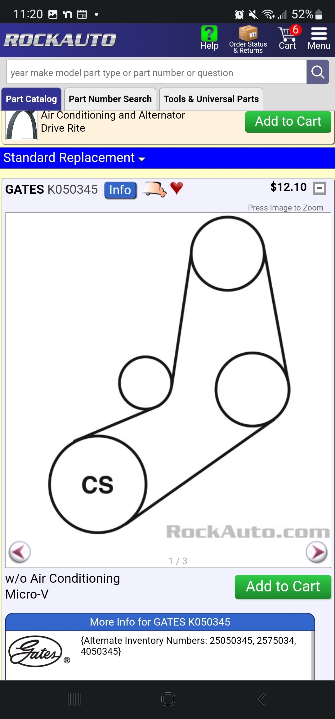

And just run the serpentine belt around the output pulley and alternator pulley? Leaving the A/C compressor pulley unused?

Yes, you can. Here is the belt number and a belt diagram. Thank you and if you have any more questions please let me know.
