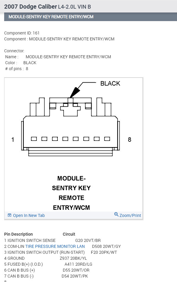

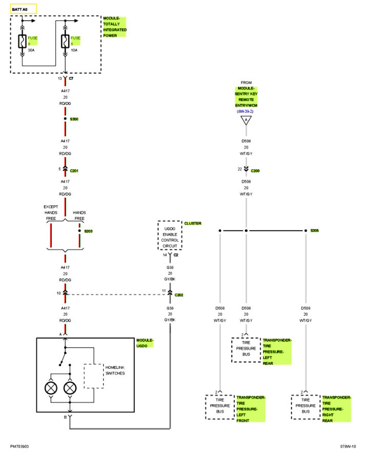

I need a Sentry Key Module wiring diagram for the car listed above SE model. Please all I can find is for 2009.

See attached for the pinout of the Sentry Key Module as well as the wiring schematics.
Let me know of any questions.
