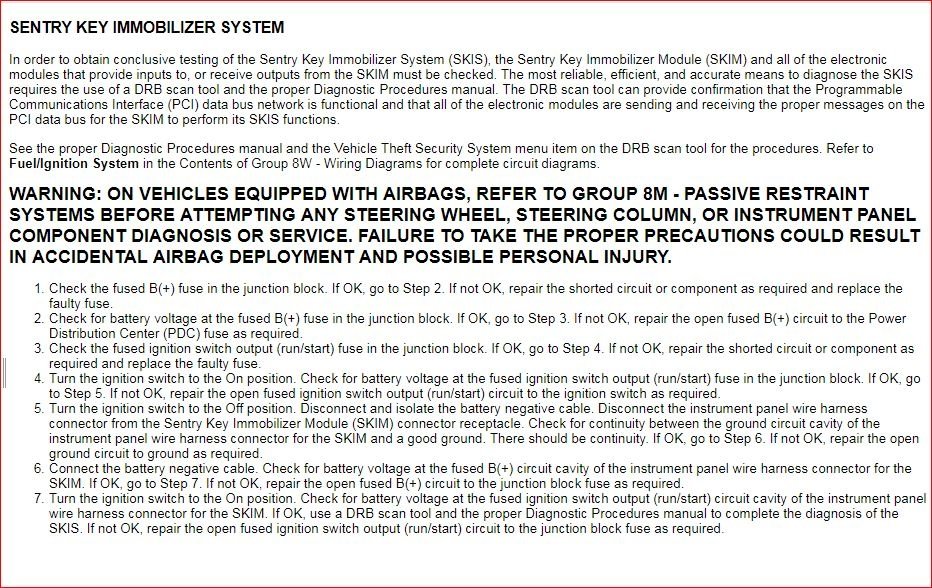

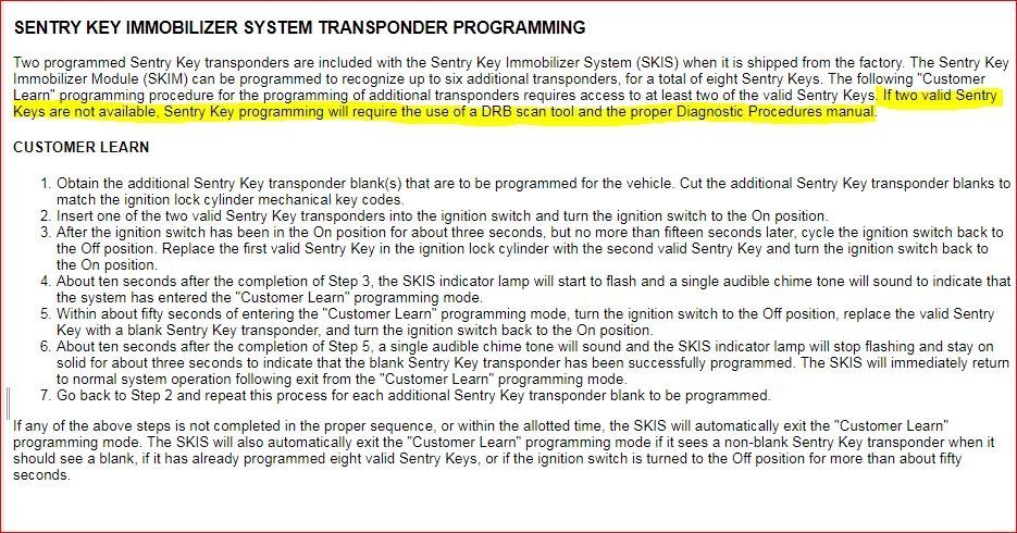

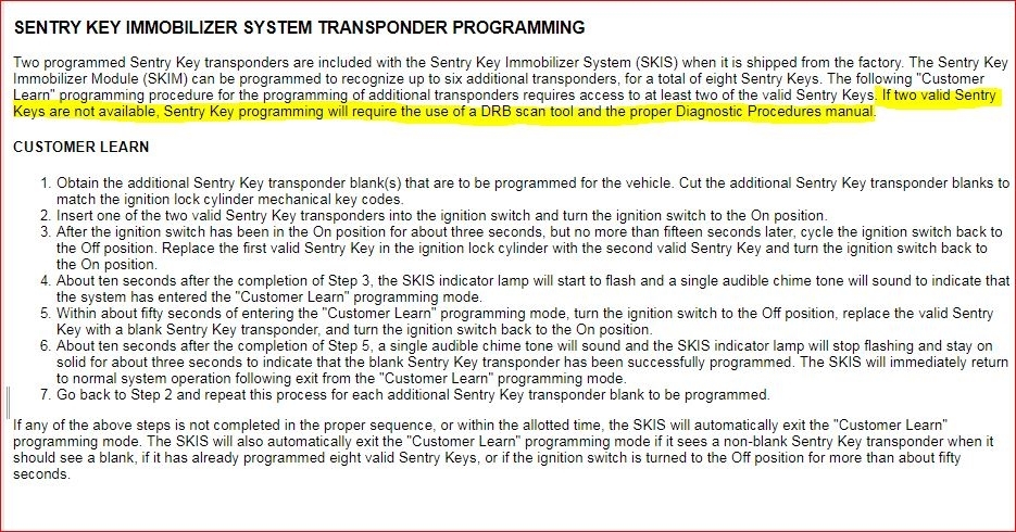

You said you changed the immobilizer from another vehicle. Do you have both keys from this immobilizer? I don't think they are VIN specific meaning you should be able to put this into another vehicle but if you do not have both keys that came with it then you cannot program any additional keys without a DRB.
I attached some information about this system. Please let me know if I am missing anything but based on the info you provided, your no start is due to the keys being shut out. I am assuming you don't have the keys so unfortunately, you are going to need a DRB.
Thanks
Kenny

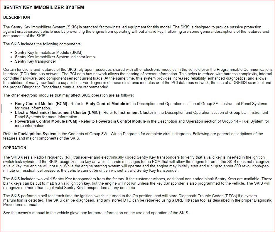

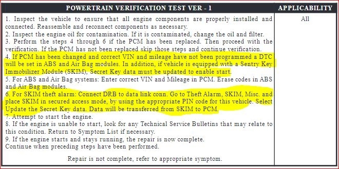

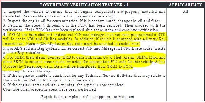

Got it. This system requires the PCM to house the secret key data as a back up in the event that the SKIM is replaced. This requires you to input the PIN so that the PCM and SKIM share the same information. The SKIM and PCM do a "secret handshake" behind the scenes of every start and if they don't match info then it prevents the start. That is basically where you are right now.
If you have the PIN for the current SKIM and two keys, then you need to use the DRB and transfer that info to the new PCM so that they can achieve this "handshake." See the attached for more detail.
I know that is not what you wanted to hear but unfortunately it is unavoidable, you must use a DRB or an equivalent tool.
