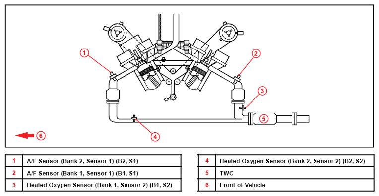

Well I had a mechanic hook it up a couple of years ago and he told me I had a n oxygen sensor not heating up right but I can't remember which one. I want to sell car so I need to take care of this. Thanks
Wednesday, November 5th, 2014 AT 7:10 AM
  • 110,194 POSTS
Okay, if the light is on and the vehicle runs properly, chances are it is an emissions related problem. I believe your vehicle only has one heated o2 sensor. If that was the code he found and it has never been replaced, I would just replace it now.

Which one is heated?
Wednesday, November 5th, 2014 AT 8:59 AM
  • 110,194 POSTS
See attached pic. Sorry, there are actually 2 on the V6
