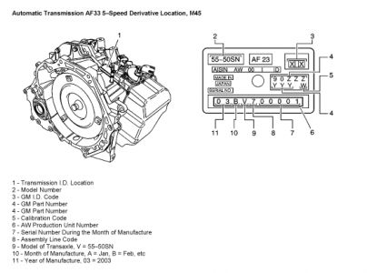

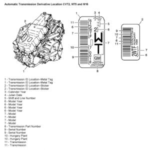

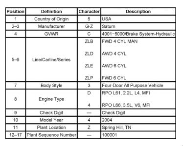

Now Im more confused. How can I tell which of these many trannys I have. It IS auto, awd. Is the case clearly marked? VIN no help?
Thursday, October 30th, 2008 AT 7:34 PM
IMPALASS
  • 3,112 POSTS
Sorry about that. I have attached the VIN info so you can see. The problem with what I show is as you see the chart, position 5-6 doesn't match what your VIN has verse the choices.
I have also attached two different transmission location/types. You may have to call the dealer and provide this data for the correct info. I don't have access to dealer info like this. I am viewing two different auto manual programs.
I hope this helps. Again, sorry for the confusion.
