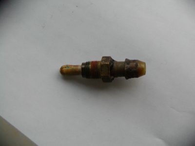

Engine coolant temperature sensor is exactly what I thought while reading this.
https://www.2carpros.com/forum/automotive_pictures/30961_saturn_CTS_2.jpg
They tend to crack (on left) and cause a variety of performance problems. I would think that it has been replaced with a brass one by now, but worth at least pulling it out and examining it.

I'm told the ECTS was changed to brass by the late 90's, so my 2002 has the brass version.
