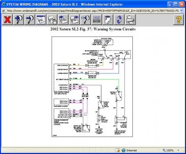

Where is chime module for headlights on or ignition on with door open?

Your car use's the body control module instead of a chime module for all the function's that the chime module would do.I posted a wire diagram for you and also emailed it to you.
https://www.2carpros.com/forum/automotive_pictures/416332_2002_SL2_warning_system_wire_diagram_1.jpg

Got your answer, have a Mac, can't print out tiny diagram. Still don't know where this module is physically located.

The body control module is under the dash top which is the top of your dash.
