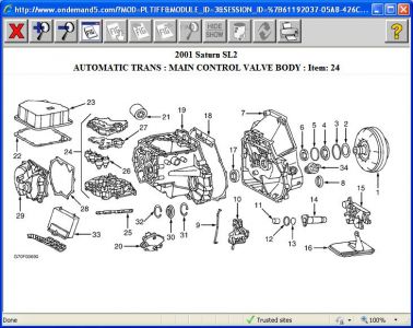

I put a new valve body in my tranny because it was slamming in reverse and now that i have the new valve body in now i do not have reverse and drive. When i try starting the car it will not start in park only neutral what am i doing wrong?

When u put the valve body on did u hook the shifter linkage back up to the valve body?let me know.

No we forgot to hook it up but we have another issue. When I pulled the new valve body back off and noticed that the shifter linkage was not hooked up I inspected the body and noticed that on the back side of the valve body there is a plunger that had almost fell out and when I checked the old one and it was spring loaded. Is it supposed to be spring loaded?

That's what I figured u forgot to hook up the linkage.can u please post a pic of this plunger so I can see exactly what ur talking about thanks.

heres a exploded view of the valve body and transmission see if u see that part in the diagram if u do let me know what number it is.
