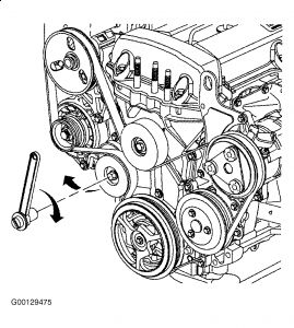

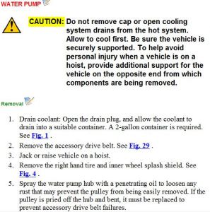

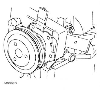

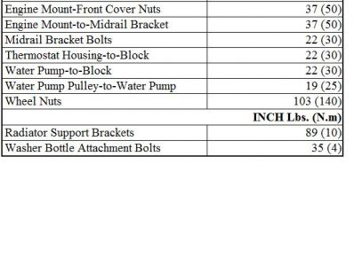

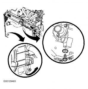

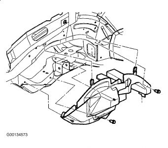

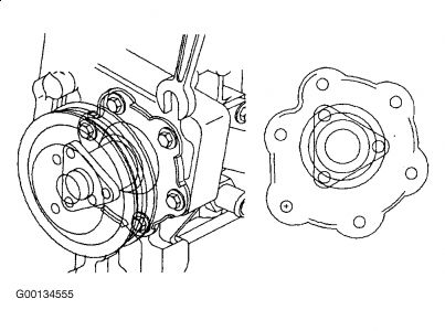

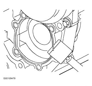

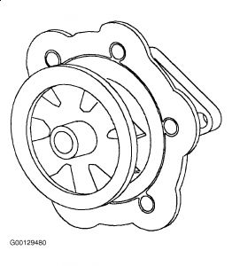

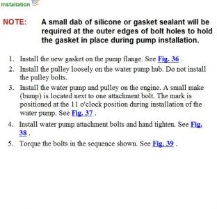

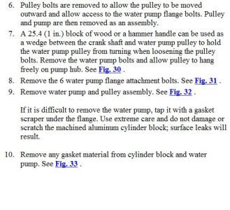

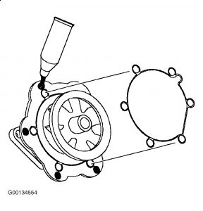

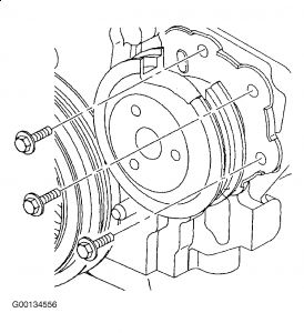

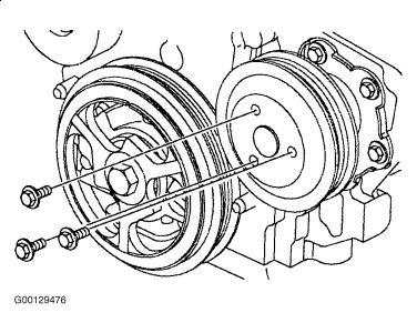

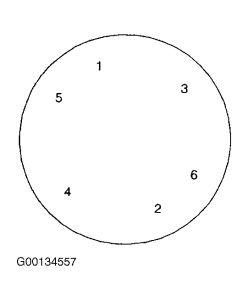

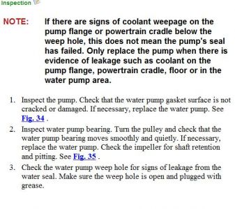

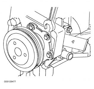

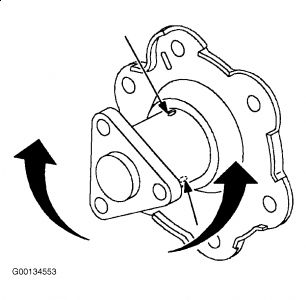

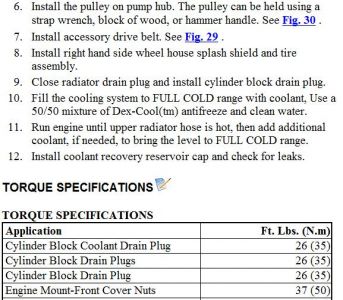

How hard is it to replace the water pump on the above car? Do you need to remove alot of items? What special tools do you need?
Mar 21, 2009 at 11:40 PM
  • 110,190 POSTS
Hi:
It is a little bit of a job on this car. What exact size engine do you have? Is it the 2.0, 2.2, or 2.4L? It doesn't require any special tools.
If you want, let me know what engine you have and I will do my best to provide directions.
Mar 22, 2009 at 12:03 AM
ZACKMAN
  • 4,202 POSTS
https://images.2carpros.com/forum/automotive_pictures/55316_00sl2wp01_1.jpg
Fig 1
https://images.2carpros.com/forum/automotive_pictures/55316_00sl2wp1_1.jpg
Fig 29
https://images.2carpros.com/forum/automotive_pictures/55316_00sl2wp29_1.jpg
Fig 4
https://images.2carpros.com/forum/automotive_pictures/55316_00sl2wp4_1.jpg
https://images.2carpros.com/forum/automotive_pictures/55316_00sl2wp02_1.jpg
Fig 30
https://images.2carpros.com/forum/automotive_pictures/55316_00sl2wp30_1.jpg
Fig 31
https://images.2carpros.com/forum/automotive_pictures/55316_00sl2wp31_1.jpg
Fig 32
https://images.2carpros.com/forum/automotive_pictures/55316_00sl2wp32_1.jpg
Fig 33
https://images.2carpros.com/forum/automotive_pictures/55316_00sl2wp33_1.jpg
https://images.2carpros.com/forum/automotive_pictures/55316_00sl2wp03_1.jpg
Fig 34
https://images.2carpros.com/forum/automotive_pictures/55316_00sl2wp34_1.jpg
Fig 35
https://images.2carpros.com/forum/automotive_pictures/55316_00sl2wp35_1.jpg
https://images.2carpros.com/forum/automotive_pictures/55316_00sl2wp04_1.jpg
Fig 36
https://images.2carpros.com/forum/automotive_pictures/55316_00sl2wp36_1.jpg
Fig 37
https://images.2carpros.com/forum/automotive_pictures/55316_00sl2wp37_1.jpg
Fig 38
https://images.2carpros.com/forum/automotive_pictures/55316_00sl2wp38_1.jpg
Fig 39
https://images.2carpros.com/forum/automotive_pictures/55316_00sl2wp39_1.jpg
https://images.2carpros.com/forum/automotive_pictures/55316_00sl2wp05_1.jpg
https://images.2carpros.com/forum/automotive_pictures/55316_00sl2wp06_2.jpg
Fig 30
https://images.2carpros.com/forum/automotive_pictures/55316_00sl2wp30_2.jpg
Fig 29
https://images.2carpros.com/forum/automotive_pictures/55316_00sl2wp29_2.jpg
Mar 22, 2009 at 12:34 AM
