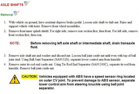

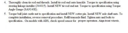

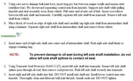

Suspension problem
2000 Saturn SL2 4 cyl Two Wheel Drive Automatic
How can I replace the front driver side axle?
Monday, February 8th, 2010 AT 10:46 PM
BLUELIGHTNIN6
MECHANIC
16,542 POSTS
Monday, February 8th, 2010 AT 10:57 PM
