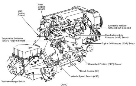

were is the camshaft sensor on the motor and how do I get to it.

This model does not use a camshaft position sensor.
However it has a Crankshaft position sensor.
