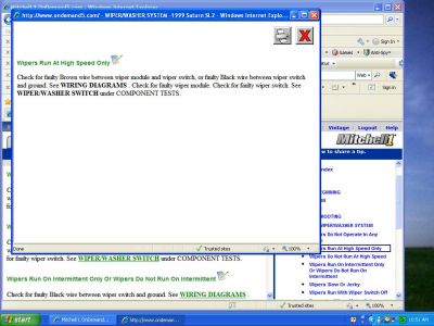

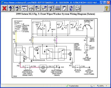

the wipers on my car only work on the highest setting and turn on and off randomly. also, the windshield wiper fluid sprays at my windshield until it is empty and even when it is empty it always tries to spray more.

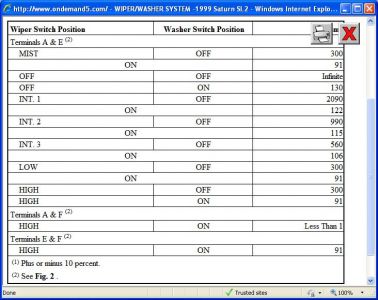

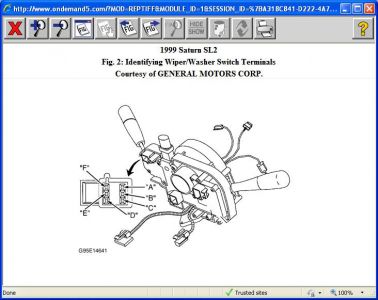

here is the trouble tree for wipers only work on high. i also gave you a wire diagram so you can trace and see why your washer motor runs all the time you will need a volt ohm meter so you can do some testing.let me know what you find and if you have anymore questions.
