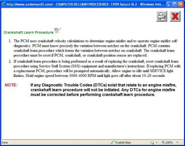

I have a new computer & crankshaft sensor
and the crankshaft sensor will not relearn

What procedure are you using to relearn the crank shaft sensor?

I get a code P1336 I have a digital obd2 code reader
i take out the code but it comes back

Try this procedure and you should be able to clear that code after you do it.Let me know how it come's out.
