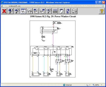

And finally, I am having an issue with the Power Windows. The windows on the passenger side are working, the ones on the driver side do not work. When I depress the button, there is no battery draw whatsoever. No motor sound or anything. I did notice that the driver's window is a bit off track, but the rear window is fine. Could the switch be bad? Or do I need to take the door panel off and check the motor/regulators? Where are the screws to remove the center console to get to the switch?

https://www.2carpros.com/forum/automotive_pictures/416332_1998_sl2_window_wire_diagram_1.jpg
starting with ur running hot sounds normal to me they run up into the half way point this is normal.when ur stop and go or idle the air u would have comming thur the radiator is from ur fan untill this turns on u have no air flow thats why the temp gauge goes up if it didnt i would suspect u have a bad thermostate letting the coolant circulate all the time.as for ur a/c if u want to check ur fuse relay and a/c compressor clutch and radiator cooling fan all in on shot.then start and let ur car idle then go behind ur underhood fuse area on ur a/c line u will see a high/low sensor screwed into the line with two wires going to it.make sure something didnt chew the wires up if so then u will have to make a repair there before u go any further.if all is good then unplug that connector be sure to remove the little plastic lock tab first if its still there.then jump those two terminals together the radiator cooling fan should come on along with ur a/c compressor.then u know all that is good.check that out most likely u just have a low charge in the a/c system.as far as ur window switch ur working too hard u dont have to remove ur center console to get to ur wires or to remove the switch.there is a retaining tab on the back of the switch behind the power mirror switch control.take a couple of small pocket screwdrivers to release the tabs place the screwdrivers between the console and switch.as far as ur rear window goes have someone work the window switch for that window up and down and u listen for the motor running up and down at the door if it does then u have a broken plastic retaining clip on the regulator.u can get the plastic clip seperate from regualtor at the dealer much cheaper then the whole regulator.i also post a window wire diagram for u.let me know what u find.
