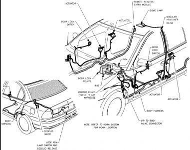

Where is the keyless entry module on a 1998 4-door sedan Saturn SL2?

Hi carl51, Welcome to 2carpros and TY for the donation
Remote Keyless Entry (RKE) And Security System Component Location
