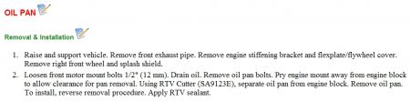

We need to remove the oil pan in order to fix a leak. We need to remove the pulley in order to get to the oil pan. Is the bolt that is holding the pulley a right hand or left hand thread?

No need to remove any pulleys...what pulley you talking about? to replace oil pan on this vehicle follow the steps below..
https://www.2carpros.com/forum/automotive_pictures/261618_Noname_2659.jpg
