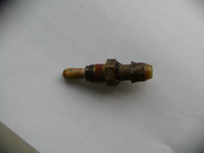

Setting that aside, the Saturn 1.9 motors had there share of problems with the coolant temp sensors on them.
https://www.2carpros.com/forum/automotive_pictures/30961_saturn_CTS_3.jpg
IF you look on the right side, you can see where it cracked. The symptoms from these vary, but most often related to the cold start.
Clear the codes..erase the data in the pcm, and drive it and see if anything returns.
