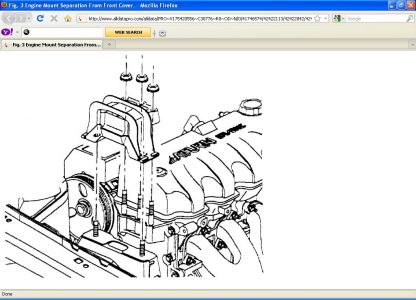

1996 Saturn SL2 4 cyl Manual 90000 miles
My car has a loud vibration that sounds like it is coming from the engine towards the passenger side floor board. The vibration is worse at times and sometimes non-existent. It tends to always vibrate whenever I start my car and the RPM's are higher while the car warms up. It also vibrates more during left turns than right turns. If I am driving on the highway and suddenly decelerate the vibration is very bad unless I shift into nuetral in which case the vibration is much more subdued.
I've had people tell me everything from vacuum leaks to engine mounts, or my transmission. Please help me.

https://www.2carpros.com/forum/automotive_pictures/416332_1996_saturn_upper_mount_1.jpg
Check that mount your engine is different i know but the mount is the same.See if it's torn or colasped from what you describe it should be pretty easy to spot if that mount is bad.
