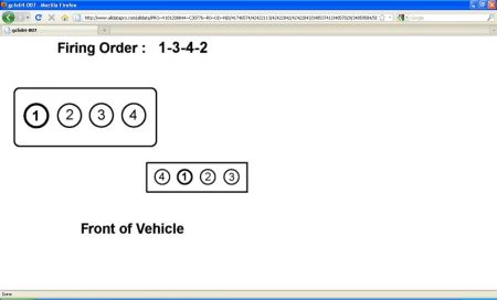

SATURNTECH9
  • 30,869 POSTS
https://www.2carpros.com/forum/automotive_pictures/416332_1996_SL2_firing_order_1.jpg
I posted the firing order for you the big box show's the cylinder location's on the engine and the small box show's the coil's and which cylinder's go to which coil's.Please double check for me i want to cover all are base's here.Also you don't want a platnuim or split fire plug's in your engine you just want a stock plug.Let me know the make and number of the plug's you have in your engine.
Friday, September 24th, 2010 AT 4:02 PM
NATTS
  • 9 POSTS
I checked the wires against you pic. The plugs are bosch FR8DPX platinum
Friday, September 24th, 2010 AT 5:48 PM
