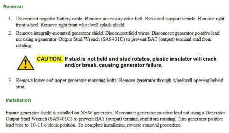

What does it typically cost to get an alternator replaced? How hard is this job to do yourself?
Thursday, February 25th, 2010 AT 8:03 PM
BLUELIGHTNIN6
MECHANIC
16,542 POSTS
Thursday, February 25th, 2010 AT 8:07 PM
