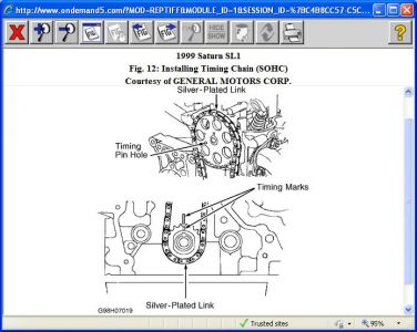

How do I set the timing marks on my Saturn?

theres ur timming mark set for ur timming chain is ur old timming chain on or off right now?
