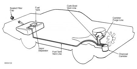

Thank you. Question, should I still replace evap. Emission purge solniod on the gas filler neck? I purchased a new from a Chev/Saturn Dealership at lunch today. If I remmber what you told me, turn the igition to acc (do not start the engine) and unplug and plug the electrical connector to see if the solniod clicks.
Where is the canister in the engine compartment?

Charcoal canister looks like black coffee can
https://www.2carpros.com/forum/automotive_pictures/198357_Graphic_481.jpg

Last question, how can you tell if the Charcoal canister is bad vs Evap Emssion Purge solnoid?

If solenoid does not click then it's faulty if power to it is verfiyed. Canister will not allow air to pass through

Once again, 2Carpros nailed the problem! My Saturn is back on the road!
