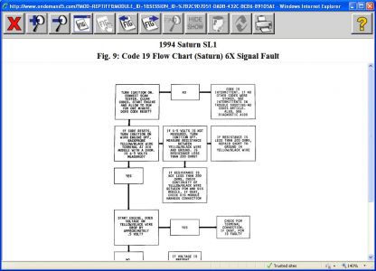

I put a 2000 sl1 engine head and block in my 94. I transferred intake and manifold. Now I have a ignition code popping up. I was told it was because the cranks are different. I used the 1994 blown up engines cam sensor, will useing the 2000 cam sensor fix my problem or is there a way of fixing it. The car runs fine.

Let's start with what code do u have popping up?Let me know.
Wednesday, April 14th, 2010 AT 3:09 PM
ETCH
19 ignition control 6 times
41 ignition control malfunction
44 oxygen sensor lean
53 knock sensor to much knock present
Thursday, April 15th, 2010 AT 9:13 AM

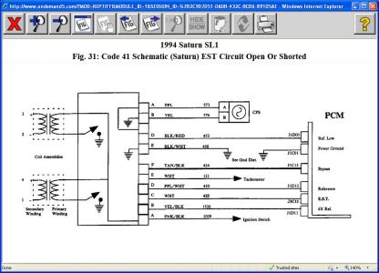

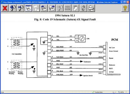

the crank for 2000 sl1 and 1994 sl1 is the same it doesnt appear its the wrong is the problem.i gave u the 6x wire diagram and trouble tree ur code 41 is for ur knock sensor fault the electricial part of it.ur 53 is just a info flag usually goes with the 41.trace that code 19 down and let me know what u find there that may fix some of those other codes.let me know what u find.
Thursday, April 15th, 2010 AT 12:23 PM

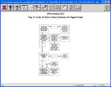

https://www.2carpros.com/forum/automotive_pictures/416332_1994_6x_trouble_tree_part2_1.jpg
sorry about that the first 6x trouble i posted for u was cut off heres the complete one.let me know what u find.
