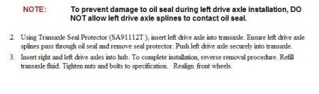

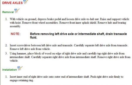

Drive Train Axles Bearings problem
1994 Saturn SL1 4 cyl Front Wheel Drive Manual
How do I replace the front passenger side axle on my 1994 saturn SL1
Tuesday, November 3rd, 2009 AT 9:38 AM
BLUELIGHTNIN6
MECHANIC
16,542 POSTS
Friday, December 4th, 2009 AT 10:54 PM
