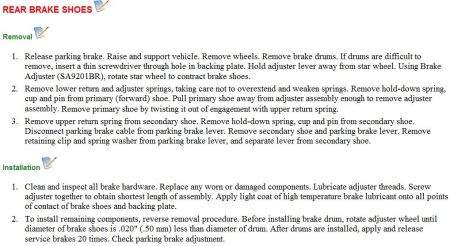

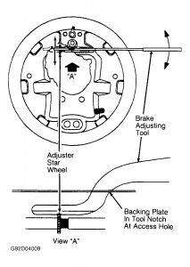

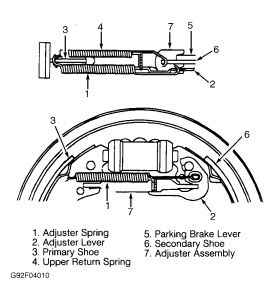

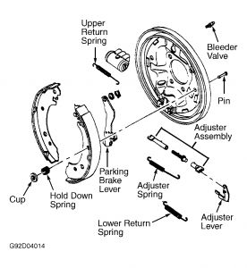

How do u change the back drum brakes can u send me a map of them
Thursday, October 21st, 2010 AT 8:15 PM
BLUELIGHTNIN6
MECHANIC
16,542 POSTS
Thursday, October 21st, 2010 AT 8:19 PM
