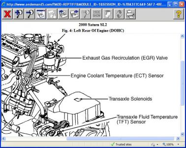

Engine Cooling problem
1998 Saturn SC2 4 cyl Two Wheel Drive Automatic 1.9 miles
i cant seem to find the fan switch or sensor switch

https://images.2carpros.com/forum/automotive_pictures/416332_2000_sl2_coolant_temp_sensor_4.jpg
I posted a diagram of where it is make sure you inspect the connector going to it if it's corroded then replace the connector also.If you replace the sensor make sure you get a brass tipped sensor the plastic tipped one's crack.
