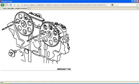

How to set the timing

Are you looking for the timing chain timing?

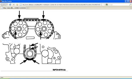

https://www.2carpros.com/forum/automotive_pictures/416332_1997_SC2_timing_marks_part1_1.jpg
https://www.2carpros.com/forum/automotive_pictures/416332_1997_SC2_timing_marks_part2_1.jpg
CAUTION: Excess slack in the chain must be kept to the chain tensioner side (movable guide) of the cylinder block when installing timing chain or the camshaft sprockets will not be correctly timed to the crankshaft sprocket.
6. Make sure the silver colored link plates are located over the pip mark on the cam sprockets only. The crankshaft sprocket tooth must be pointed directly downward at the 6 o'clock position between the two silver colored links. The pip mark on the crankshaft sprocket will be aligned with the timing mark on the cylinder block.
There you go.

Hello I set the timing the same way you should me on the diagram but it seem to be dumping alot of gas and the car wont start
