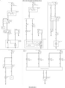

Situation:
future son-in-law's car was parked at school on a very cold morning. Kid gets in car after school and tries to start car. Only hears a "click" (thats all he can remember).
gets his dad to replace battery. Tries to start car but only hears "click" (again, thats all he remembers). I checked voltage to + terminal at starter and got 12v. When I try to start the car I hear the injectors buzz, all dash lights are on but no "click" (as you would hear when the relay pulls in). Also, the dash lights do not dim so I suspect the relay and/or something else in the circuit (i will check park/neutral switch later this a.M.). Other than that, is there anything else I could check (i can not find location of starter relay). Please advise. Thank you, tony

To locate the starter relay ,remove the underhood junction block cover, located on the left side of the engine compartment.
There are 2 wires from it. One is yellow and goes to the neutral start switch.
The R/B color goes to RKE module..
I suspect a bad starter.
I'm sensding the wiring diagram to your email.because this one is not visible
https://www.2carpros.com/forum/automotive_pictures/46384_0900c1528017ead2_1.jpg

Hi Tony.
I'm sending the wiring diagram for the starting and charging system; sorry you did not get the first one.
When new battery dies like that, I would suspect a wiring problem or loose/dirty battery cable. Make sure all connections are clean and tight.
The wiring diagram contains the color of the wire and there connections.
Let's not jump to the conclusion of the voltage regulator. Because I think there is loose wire or green cheese in side the battery cables.
