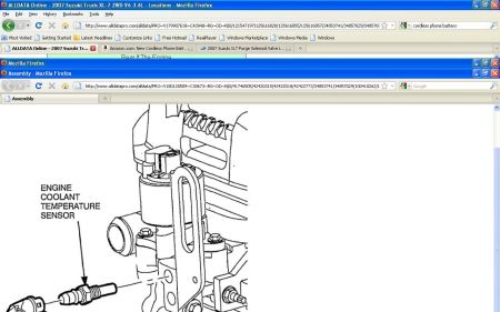

where is the cooling fan sensor

There is two it's the bottom one with two wire's going to it the one you want to change.Also make sure you inspect the connector going to it if it's corroded then you will have to change the connector too.Make sure you get a brass tipped sensor the plastic tipped one's crack.
