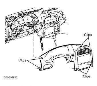

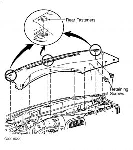

What is the best way to remove the part of the dash (trim) that goes around the radio and speedometer ? There are no screws or pins visible and it won't just pop off ! Thanks!!!!! L.

The retaining screws are on passenger's side , above glove box. Remove then lift front edge of trim panel. Disengage the rear fasteners by reaching under the trim panel and lifting straight up.
