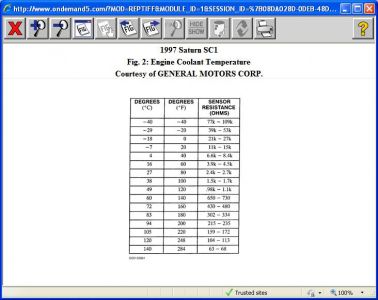

I replaced the temp sensor with one from advanced auto parts $11.00 the cooling fan doesn't come on it just sits there and over heats. If i unplug the temp sensor the fan comes on immediately or if i turn on the air cond. it stay on as it should. The sensor harness reads 5 volts in and out when the engine is cold, as the car warms up the out gets down to about 1 volt. If I ground the relay the fan comes on as well, Im lost as what to do next, Thank-you for your valuable time. Alex

https://images.2carpros.com/forum/automotive_pictures/416332_1999_sc1_coolant_temp_sensor_1.jpg
I posted a coolant temp sensor spec chart use a ohm's meter to test the new sensor let me know what you find.
