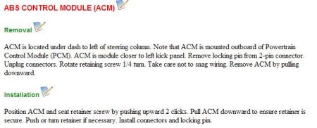

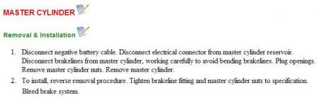

To replace brake master cylinder it looks like the abs unit must be disconnected. What is the propper procedure for this repair
