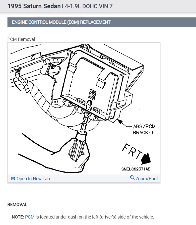

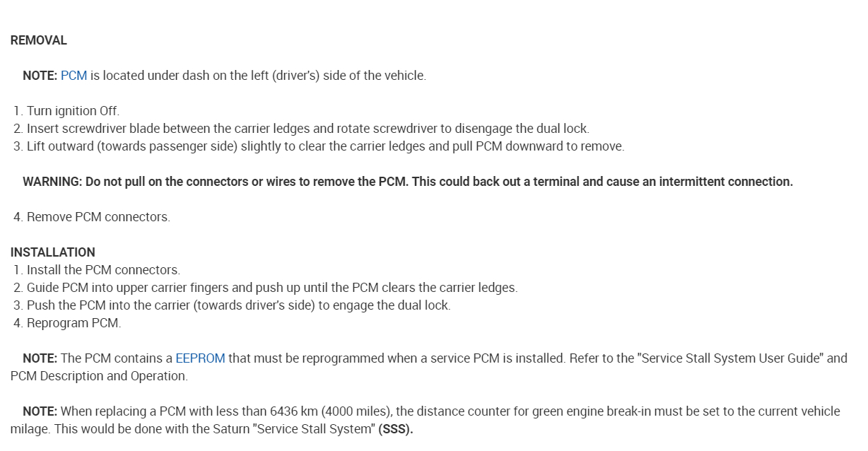

This happens when the PCM is going out, I would get a rebuilt unit by searching Google or Ebay. Here is the location so you can swap it out to fix the problem. Check out the images (below). Please let us know what happens.

Are you pretty certain this will fix? Buying a PCM for $175.00.
Wednesday, November 2nd, 2022 AT 10:48 PM
KEN L
  • MASTER CERTIFIED MECHANIC
  • 55,266 POSTS
I have seen this problem before where the PCM needs to be reset. But I cannot promise you it will fix it. You can send yours out and have it tested so be sure.
