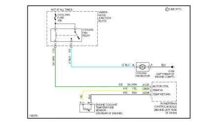

My Saturn is overheating when running the air conditioner. I have replaced the temp sensor and the fan motor recently. All of the fuses are fine and the relay appears fine too. The fan runs at high speed for a few seconds when turning on the air conditioner but then slows down and runs at low speed allowing the motor to overheat. If I have no air conditioner on the fan kicks on at high speed before reaching the red on the temp gauge and cools the engine down.

Could be a problem with the computer control of the relay-see below
https://images.2carpros.com/forum/automotive_pictures/12900_mx62_1.jpg
https://images.2carpros.com/forum/automotive_pictures/12900_mx6_1.jpg

From this diagram I can't see how the Air conditioner effects the radiator fan. I appears in this diagram the temp sensor is working properly with the control module. Do you have any other suggestions?

[quote:51a06cf6ba="paladin002"]From this diagram I can't see how the Air conditioner effects the radiator fan. I appears in this diagram the temp sensor is working properly with the control module. Do you have any other suggestions?[/quote:51a06cf6ba] I also don't see where there could be 2 speeds of the radiator fan. Thanks ahead for your reply

Sir, which fan are we dealing with and do you have 2 fan motor-perhaps the engine temperature gauge switch is involve here.
Some system uses the coolant temperature sensor to activate the condenser fan and the engine temperature gauge switch is for the radiatorfan. In your system it doesn't show a control module controlling the speed of the fan/s

It just has one radiator fan motor. This is the motor that slows down. It is very easily removed. The temp gauge and the coolant temp sensor are the same device. I know on the older models they are separate. (I have a 1993 Saturn also) I didn't think it would have different speeds either. But when I start the air conditioner it blows on high the it slows down after a few seconds. The motor seems to slow down it's idle too. This is the same problem I had when I replaced the fan motor to begin with. It seemed to work fine for a while after that. Could it possibly be the new fan motor or maybe somehow when the air conditioner is turned on it draws power and causes the motor to slow. It still blows on high when the motor gets hot and cools it down. It will not do this with the air conditioner on. I appreciate your time helping me.

New fan motor ???????? or maybe there's an idle up solenoid valve that's acting up.Its job is to increase RPM when compressor engages when command by the computer.
