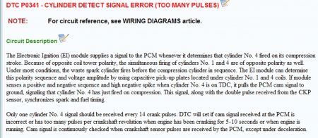

I have a 98 Saturn sl2. the problem I am having is an intermittent sputter. It only happens in wet road conditions. what happens is while driving it will sputter for 1 to 2 seconds and clear up. The service engine soon light will come on and stay on. The code I have is P0341 (camshaft Position Sensor A - Bank 1 CKT Range/Perf). I know that there is no camshaft sensor so I don't know why this code comes up. Also The way I get the service engine light to go out is to shut off the car remove the gas cap for 20 seconds, reinstall the cap, and start the engine and the light is off. The car has been serviced by Saturn for this problem and they changed the plugs and wires, and "reconditioned" the coil pack. Any Ideas would be very helpful. Thank You T. Mates

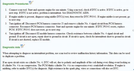

Here's what your looking for, and how to do it...
https://images.2carpros.com/forum/automotive_pictures/62217_p0341a_1.jpg
https://images.2carpros.com/forum/automotive_pictures/62217_p0341b_1.jpg
https://images.2carpros.com/forum/automotive_pictures/62217_p0341c_1.jpg

Thanks for the help!!! If I understand you correctly the problem can be related to the weather conditions like an old distributor cap getting wet. Looks like I have a bit of work to do.

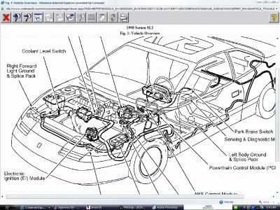

Check under the coils for cyl 1 and 4 it's paired that way, then test for a bad PCM or EI module. The tests are in your email so you can read!

Is the PCM (powertrain control module) the same as what I remember called the eccm (electronic control module) aka main computer? Sorry, but it's been a long time since I had to work on computer issues in cars.
Ok I finally got a good look at the EI mod. I didn't realize that it was all separate pieces (2 coil packs and an Ignition Control Module underneath with a plug). The PCM checks ok but I see the plug for the EI has corrosion around the plug at the ICM. That is probably my problem there.

Could be see if you can clean it out, disconnect the battery, get some electrical contact cleaner, clean the connectors, let dry and see if it helps...
