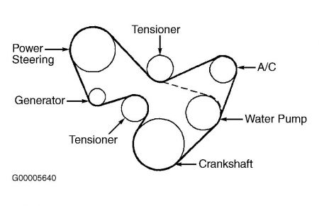

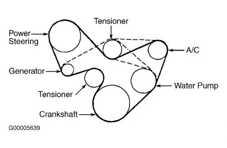

Can you tell me how to replace a serpentine belt

Need to know
model?
Engine size?
AC or not----

It is an SL2, engine size is 1.9 liter
and yes a/c
thank you

Locate the belt tensioner and pull away from the belt then remove the belt
DOHC engine
SOHC ENGINE
