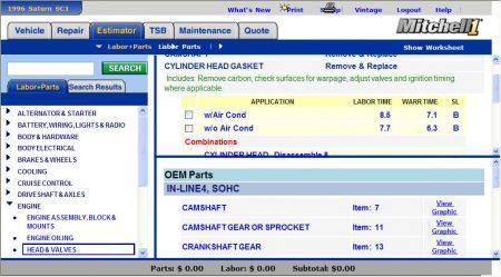

White smoke points to coolant being burn in the combustion chamber to confirm headgasket get it block and pressure tested. The cost of repair in terms of labor varies with location could range from $70-$130.00 per hr. Also see below
https://images.2carpros.com/forum/automotive_pictures/12900_labor_time_1.jpg
