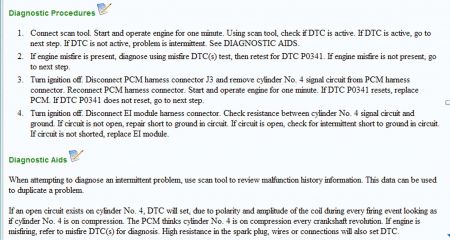

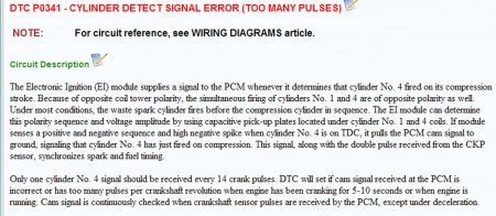

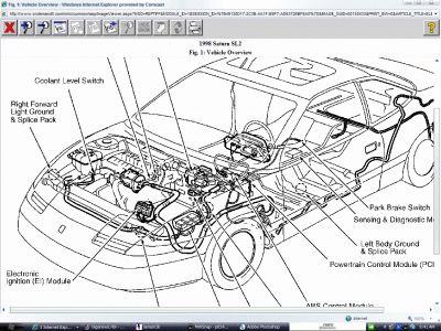

I had a diagnostic check done on car because the engine light came on and it read, "camshaft position sensor bank 1. Pkt/perf. Can you please tell me what that means and where it is located. I would like to try and fix the problem myself. Thanks
Friday, March 28th, 2008 AT 3:02 PM
MERLIN2021
  • 17,250 POSTS
It more than likly means you need to replace the ignition module, located by the radiator, Have seen a few in this forum in my day!
