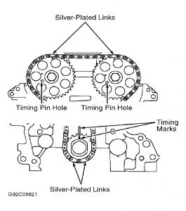

I NEED TO KNOW THE TIMING MARKS ON A 94 SATURN SL2 TWIN CAM. IF POSSIBLE PICTURES

Here is a diagram of the timing for a duel cam
