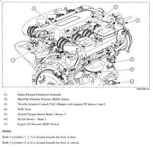

Engine Performance problem
2003 Saturn L300 6 cyl Front Wheel Drive Automatic
where is the egr valve located
Monday, March 8th, 2010 AT 10:41 PM
2 Replies
MECHANIC
75,992 POSTS
Monday, March 8th, 2010 AT 10:47 PM
SATURNTECH9
MECHANIC
30,869 POSTS
If ur facing the engine it's on the left side back of the intake manifold.
