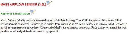

How do i change the mass air flow sensor in my 2002 sautrn L300

The MAF sensor is located on the air intake duct, under the hood and looks like the picture below..
https://images.2carpros.com/forum/automotive_pictures/261618_Noname_1317.jpg
https://images.2carpros.com/forum/automotive_pictures/261618_Noname2_395.jpg

Thanks, didnt actually expect a picture from you all....that is very helpful. Is it very hard to do yourself. also, just want to know if car will run without it? Would like to know if it can just be unplugged? lol

if you unplug the MAF sensor then the engine will idle very poorly and may even stall out. you will need to replace it. it is very simple, just a few bolts and an electrical connector is all that needs removed. keep your old one though and take it back to your auto part store for a core charge refund, most auto part stores charge a core price for MAF sensors.
