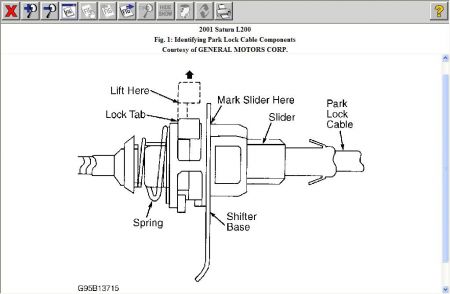

First off let me say this is the worse car I have ever owned.
Now that that's out of the way, my Saturn L200 will not shift out of Park unless I turn the key to the position where I can listen to the radio, then shift the car to neutral, start car and shift it into Drive. I've read online about disabling the cable or the nylon pin that locks the shifter but not sure I want to try that myself. Oddly enough the cruise control stopped working at the same time. Oh the trunk light also flickers on and off in cold weather. Could they all be related?

The park lock cable has gone out of adjustment and readjusting it would solve the problem.
PARK LOCK CABLE ADJUSTMENT
1. Place gearshift lever in Park position and remove ignition key. Remove cup holder/ashtray assembly. Lift lock tab on park lock cable end. See Fig. 1 . Depress gearshift lever button quickly 3 times to set starting position of cable. Using a sharp pencil, mark starting position on slider.
NOTE: Adjustment may move when lock tab is pushed. Proper operation must be verified prior to reassembly.
2. Using a feeler gauge for adjustment, move park lock cable towards shifter base .049" (1.25 mm). Push lock tab of park lock cable end to set position.
3. With ignition switch turned to LOCK position and gearshift lever in Park position, attempt to shift out of Park position. Gearshift lever should not move. Turn ignition switch to ON position. Gearshift lever should be allowed movement from Park position. Place gearshift lever in any position except Park position. Ignition switch should not be able to be turned to LOCK position and key should not be removable. Place gearshift lever in Park position. Ignition switch should be able to turn to LOCK position and ignition key should be removable.
4. If park lock cable does not operate as specified, readjust cable. Check gearshift cable adjustment. Install cup holder/ashtray assembly.
https://www.2carpros.com/forum/automotive_pictures/192750_ParkLock01SaturnL200_1.jpg

Wouldn't the cable not work in releasing the shift lock starting it the way I am if it was just an adjustment problem? I'm confused why it would work one way and not the other.
Monday, January 26th, 2009 AT 11:07 AM
KHLOW2008
  • 41,814 POSTS
Sorry for delay in answering, was away.
You don't have to worry about being a pest ;). You are always welcomed to ask anything till you are satisfied.
I am having diffiulty understanding your question and hope my answer is what you are looking for.
Presently you can move out of Park only in the ACC ( IGN I ) position. If you turn the ignition switch to RUN ( IGN II ), the cable being out of adjustment ( could be something stuck ) is not able to release the Park lock. This would not allow you to move out of Park when the engine is running as the key would be in the RUN position.
Cable need to be adjusted to be able to free the park lock when the key is in the RUN ( ON ) position.
