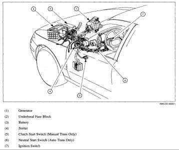

Where is the clutch neutral switch located on the vehicle to replace it?
Jan 14, 2010 at 12:20 PM
  • 75,992 POSTS
Clutch Switch Location View

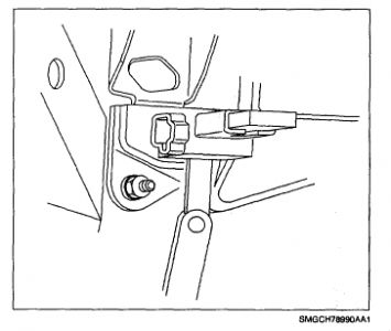

REMOVAL
https://images.2carpros.com/forum/automotive_pictures/12900_cs2_2.jpg
1.Remove lower I/P closeout panel. 2.Disconnect clutch start switch electrical connector. 3.Insert feeler gauge between switch and clutch pedal bracket to release locking tab. 4.Slide switch downward to remove from bracket. INSTALLATION

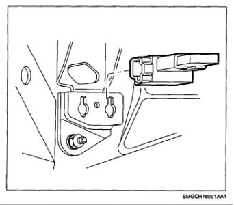

https://images.2carpros.com/forum/automotive_pictures/12900_cs3_1.jpg
1.Insert switch tabs into bracket and slide switch upward until locking tab engages. 2.Connect clutch start switch electrical connector. 3.Install lower I/P closeout panel.
