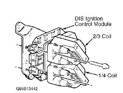

2000 Saturn L100 4 cyl Front Wheel Drive Automatic 98000. Miles
How can I access to my car plugs, I see no plug wires on the car. I need your assistance asap.
Thank you
Friday, January 23rd, 2009 AT 12:10 AM
BLUELIGHTNIN6
  • 16,542 POSTS
Should be four spark plugs on the 2.2L engine installed under the Ignition Control Module. Remove the four bolts on top of the engine that hold down the black plastic cover and lift out.
https://www.2carpros.com/forum/automotive_pictures/261618_fig3_3.jpg
