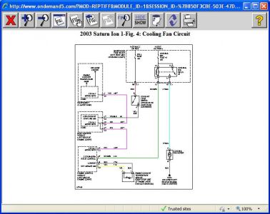

Recently i had the engine replaced after 112000 because one of the head gasket cracked. I ended up getting a different engine with fewer miles instead. The Fan Does not seem to be working now and the car over heats when the car sits for a good 15 minutes or if i'm driving at 30 mph or less and have the air conditionning on. I can hear that the thermostat kicks in for a bit but then it shuts off and the fan does not turn on like it used to before. Should the thermostat and coolant sensor be changed considering it's a different engine? where can i begin looking to find out what's the problem?

https://images.2carpros.com/forum/automotive_pictures/416332_2003_saturn_ion_cooling_fan_inop_part1_1.jpg

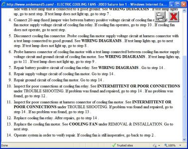

https://images.2carpros.com/forum/automotive_pictures/416332_2003_saturn_ion_cooling_fan_inop_part2_1.jpg

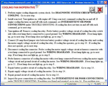

https://images.2carpros.com/forum/automotive_pictures/416332_2003_saturn_ion_cooling_fan_inop_part3_1.jpg
Give that a try.
