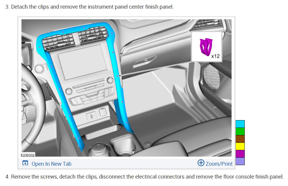

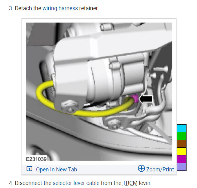

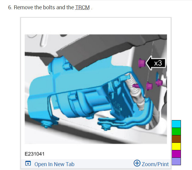

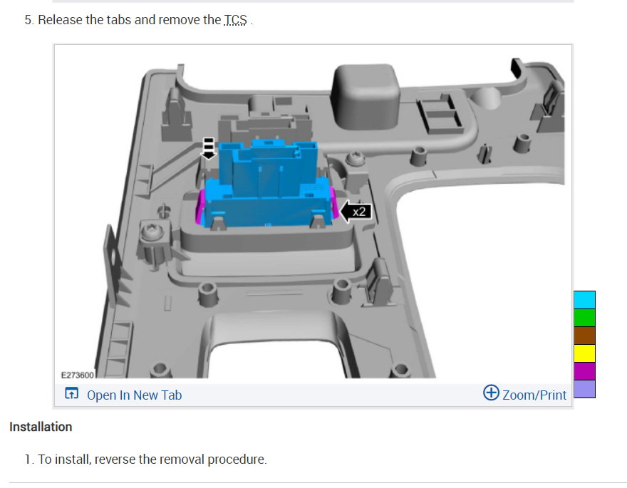

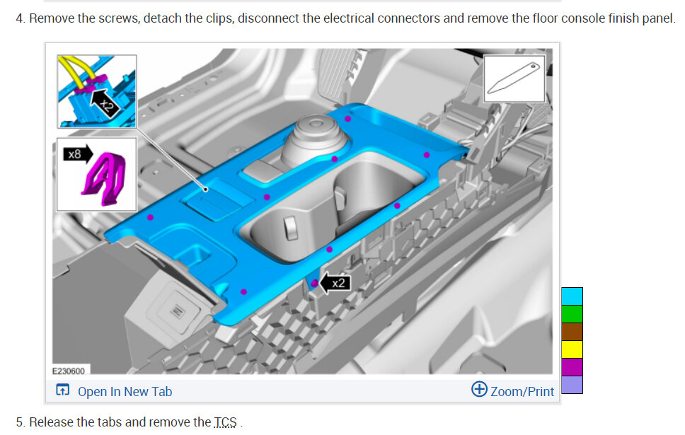

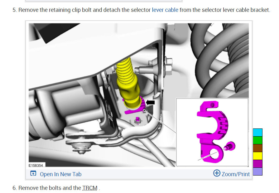

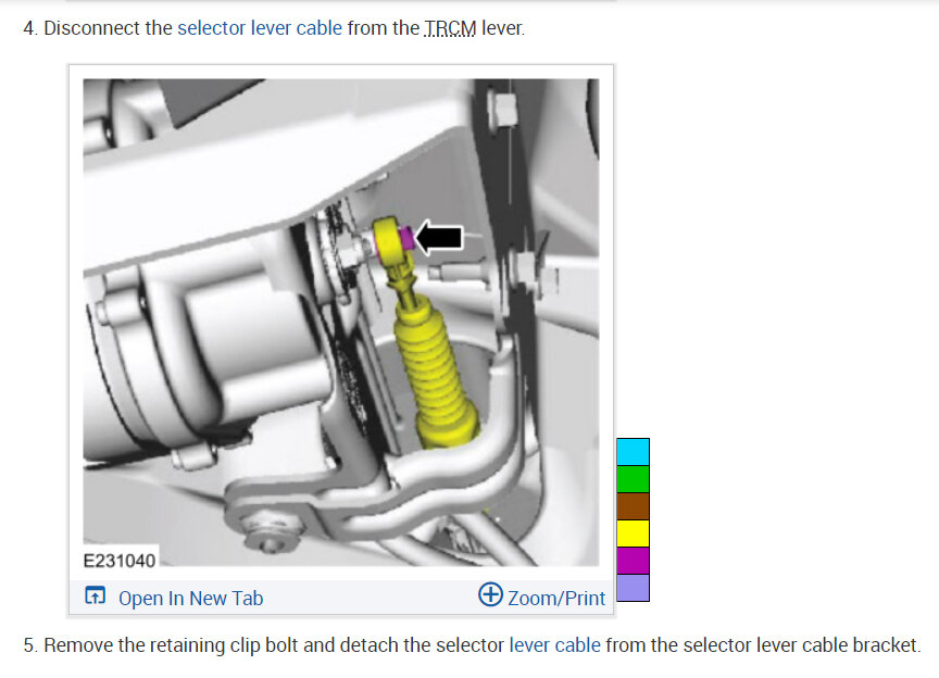

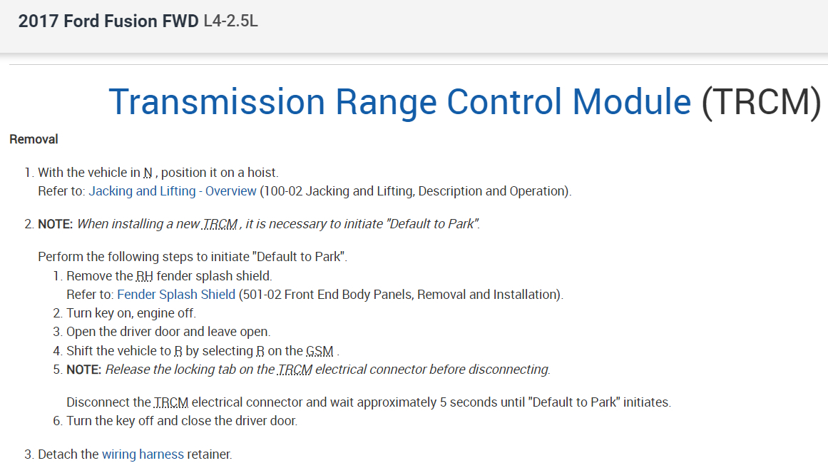

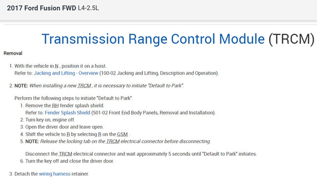

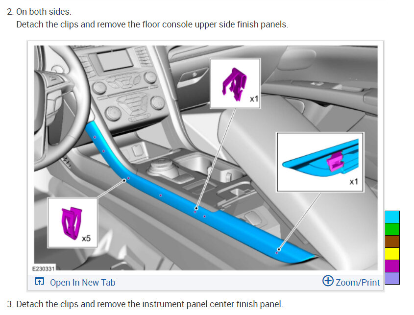

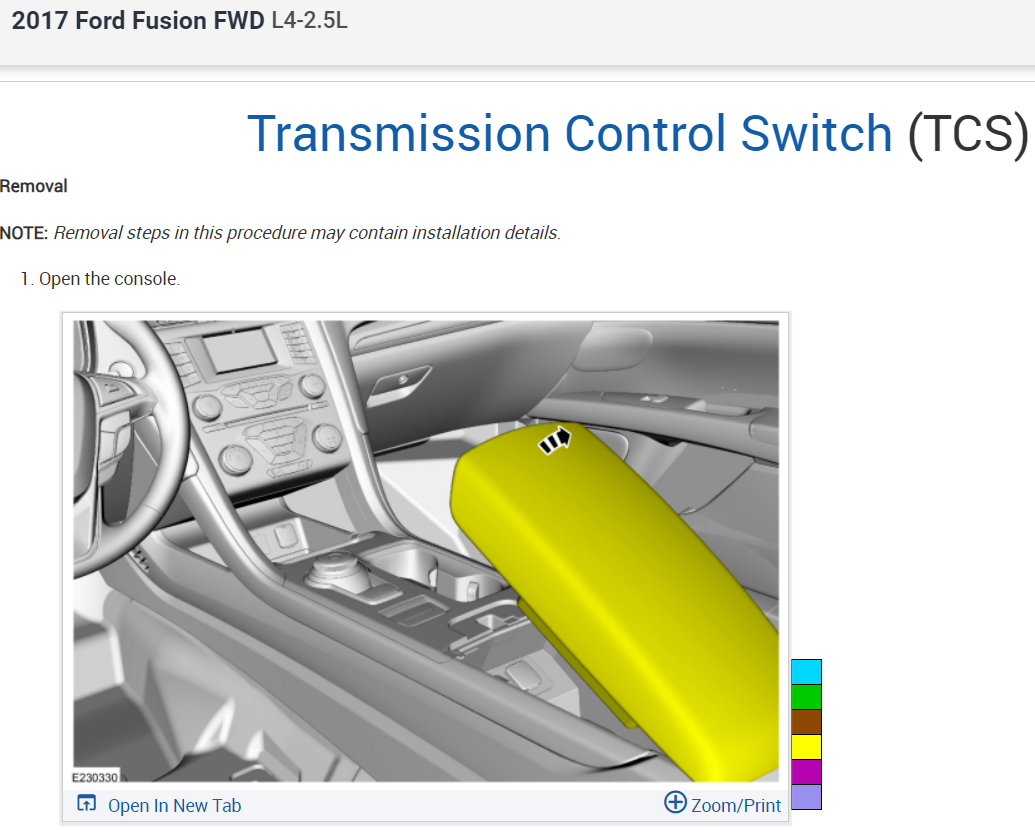

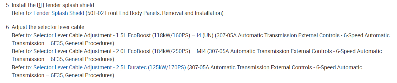

The gear shift module sounds like it is out, but to be sure we should scan the CAN. You can get a CAN scanner (Controller Area Network) which will work on most cars from Amazon.
https://youtu.be/u-4syLc-ifQ
The gear shift module is power directly from the fuse fFYI, here is how to change the gear shift module out in case you need it which should fix the problem. I must tell you there is a TRCM that can go out which might keep the gear shift module light on as well. This is why the CAN scan will help us. I have included both the gear shift module and the TRCM in case a code is stored for it. Check out the images (below). Please let us know what happens.

Yep, there is only one fuse for the gear shift module, so the light is part of the module. If you pull the fuse the transmission probably not work. I am 80% sure it will be the gear shift module that will fix the problem. Please let me know what they say.

I can get one for around $200. But since you included instructions on how to change the transmission range control module trcm it conflicts with what my mechanic says. Could you clarify if it can be done with/without dealer? The dealer wants $249 just to hook the car to the diagnostic machine!
Thursday, October 3rd, 2024 AT 10:37 AM
KEN L
  • MASTER CERTIFIED MECHANIC
  • 55,535 POSTS
The TRMS needs programming, the gear shift module does not.
