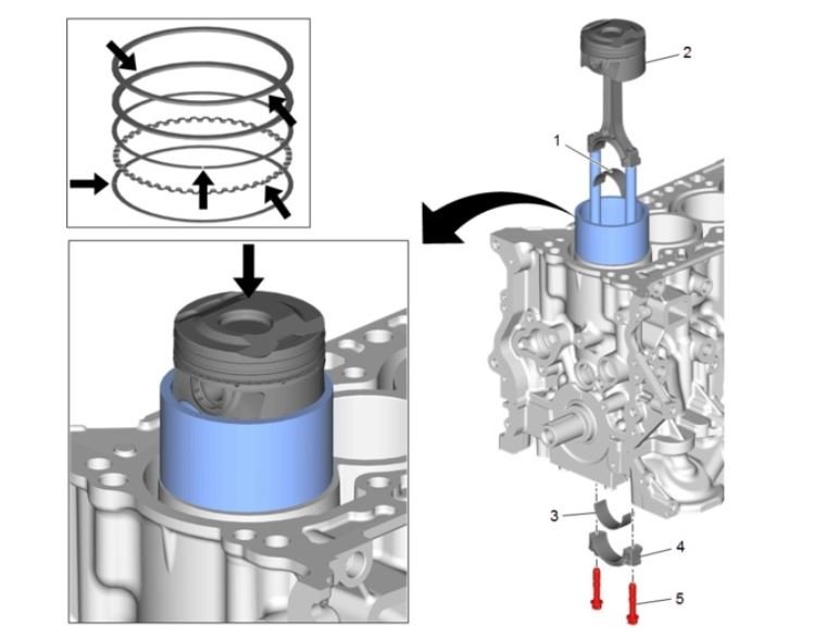

Hi, I need the to know how to orientate my gaps on my piston for my 3 cylinder engine.

Good morning,
I attached a picture of the gap locations for you.
The ring gap should be set at 90 degrees from each other.
https://www.2carpros.com/articles/replace-engine-piston-rings
