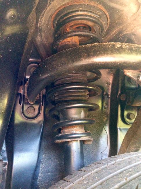

I've been hearing a loud boom every time I go over a bump in the road from the right rear wheel area for the past few days until I finally decided to jack the car up and look to see what was the problem. It's pretty obvious that there's a giant split in what looks to be the strut. I would like to get the right part just not sure what it would be. Would ordering new struts work? Or is that the whole strut assembly that is broken? I'm also interested in lowering the car so maybe new struts would help anyways. Thanks

Looks like the top of the strut rusted out and broke off looks like you need a new strut as long as nothing else broken.I dont know much about lowering I like everything stock.

So do you think I can just but the strut itself and swap it out? Struts online look way too skinny for some reason so I wasn't sure if that was an extra part on the strut. I appreciate the fast response

I would get the strut and the upper strut mount kit as well I cant see the strut on the car verus the catalog one.Where are you looking online for struts?
